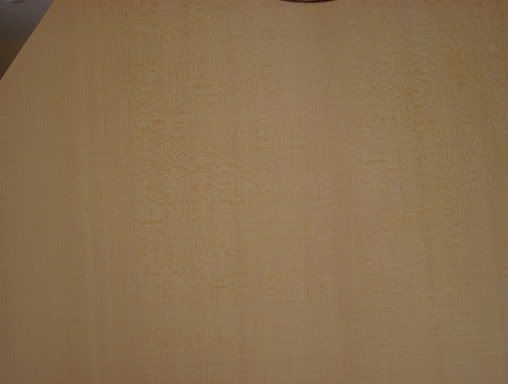

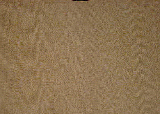

I found some interesting figure in this top, thought I would share a couple of pics with you all. I've never seen this type of curl in spruce before....well, except in the first piece I used off of this same billet. Anyway, pretty exciting stuff to me! This piece is unfinished, I wonder if the curl will be even more pronounced with some shellac on it?
Greg
Gwaltney Guitars
PostPosted: Sat Mar 18, 2006 9:14 am
Hi Greg
They are called Medullary rays or sometimes known as silking, they are a very good sign as they mean the top was cut very close to the quarter and they add cross grain stiffness, most high grade tops have them.RussellR38794.7412847222

I was under the impression that the medulliary rays were the curl kinda figure seen in quartersawn. This appears to be a visible grain pattern and not the ray figuring. Are they one in the same?
My current top has of bit of each.

I'm glad someone knew how to revise my picture so the curl showed up. I'm not sure of the exact species, I've heard it is a cross between Sitka, Engleman, and White Spruce, but I'm not really sure to tell you the truth. I bought the billet off of ebay from Mario, the man who started the other Luthier Forum that is sometimes mentioned here. I've actually got about 20 more tops like this one, at least I think I do. This seems to be really stiff spruce with nice tone, but I've never tried anything else so I'm not sure how it stacks up to the other stuff really....I would like to try some of that Carpathian or Adi. some day, just to see the difference. Thanks for looking !

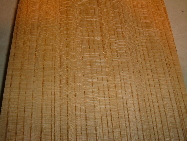

[QUOTE=j.Brown] I was under the impression that the medulliary rays were the curl kinda figure seen in quartersawn. This appears to be a visible grain pattern and not the ray figuring. Are they one in the same?
-j.[/QUOTE]
Medullary Rays (ray fleck, pith flecks, medullary fleck, medullary spots, pith flecks are some figure names) shouldn't be confused with the undulating grain that causes curl figure. Medullary rays form across growth rings and run pith to bark in direction. Medullary rays allow sap to move radially.
The prettiest ray fleck I've seen is in Keyaki, a member of the elm family. Here's a photo from a Keyaki guitar side piece.

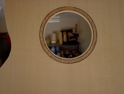

Greg, notice that the figure is around the sound hole?
Thats because you sanded the rosette and went through the different layers of silking or flek.Thats why you have a pattern.
